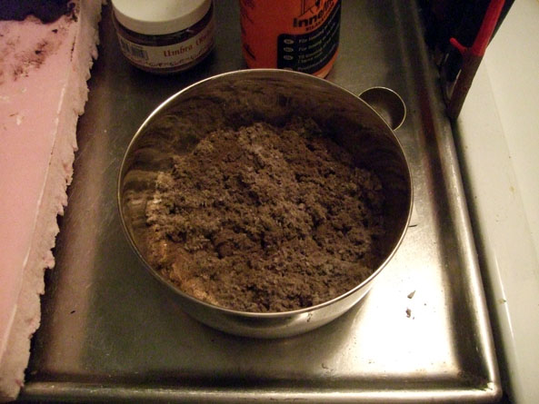

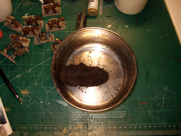

OK, my first attempt was to mix a fist of celluclay (brand name paper mache) with about 2 tablespoons of walnut wood stain...
No, I did not shit in a bowl. This is what the paper clay looks like after kneading it, dark brown. It will get lighter as it dries. After this I added a good dollop of white glue and smeared it on a piece of pink foam. I made the mix quite a bit drier this time hoping that will make it set faster than during my last experiment.
Onwards to the dry pigment. Raw umbra is quite a bit lighter than walnut stain. It is also dry so it should be added to the paper mache powder before the water. Looks like this in this stage:

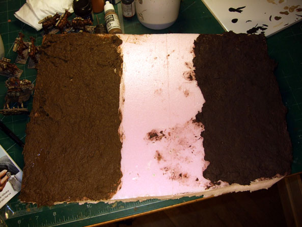

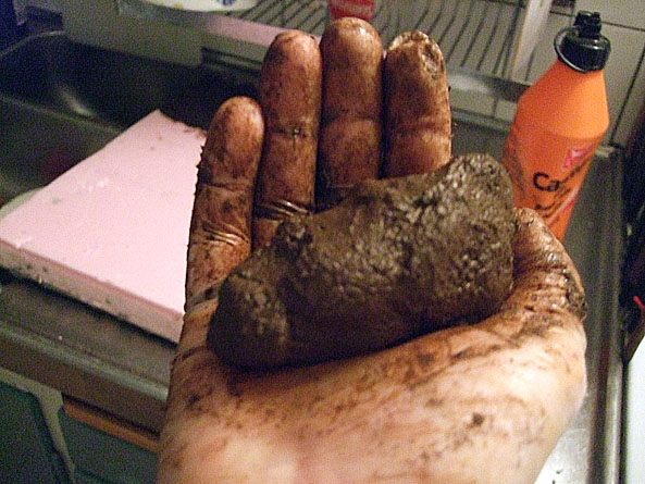

A little klear clean water was added with a few drops of flow release and the mache was kneaded till the mix was evenly coloured.
No, I am not holding faecal matter in my hand. Besides, I wear a glove. The mache is evenly coloured, glue was added and the whole thing was smeared onto the pink foam.
My, my... Pink and brown still don't go well together, do they. Quite unappetizing. The umbra stuff looks like something out of a cow. Which is probably what the dirt should look like around a rural village.

Thought I'd add a few thoughts on budget:
A bag of walnut wood stain pigment costs about 2,5 Euro will, when mixed with water, result in a 25cl tincture. I used about 30 ml with 30 grams of papiermaché. I already know I need 4kg of celluclay for a 120 by 240 cm game board. A little rough calculation based on the fact that the mache turned out too dark and I could easily have dilluted the stain much more makes me think I could do with say 5 to 8 bags meaning 12 to 20 Euros.
The dry pigment, which gave a very nice hue, is rather more expensive. There was something like 120 grams in a 6 Euro pot and I used 20 grams of raw umbra pigment with 30 grams of Celluclay. Well, it doesn't take a math genius to figure out which pigment's the cheapest.
I will use the wood stain, dilluted it some more but probably get a lighter colour, like oak.
